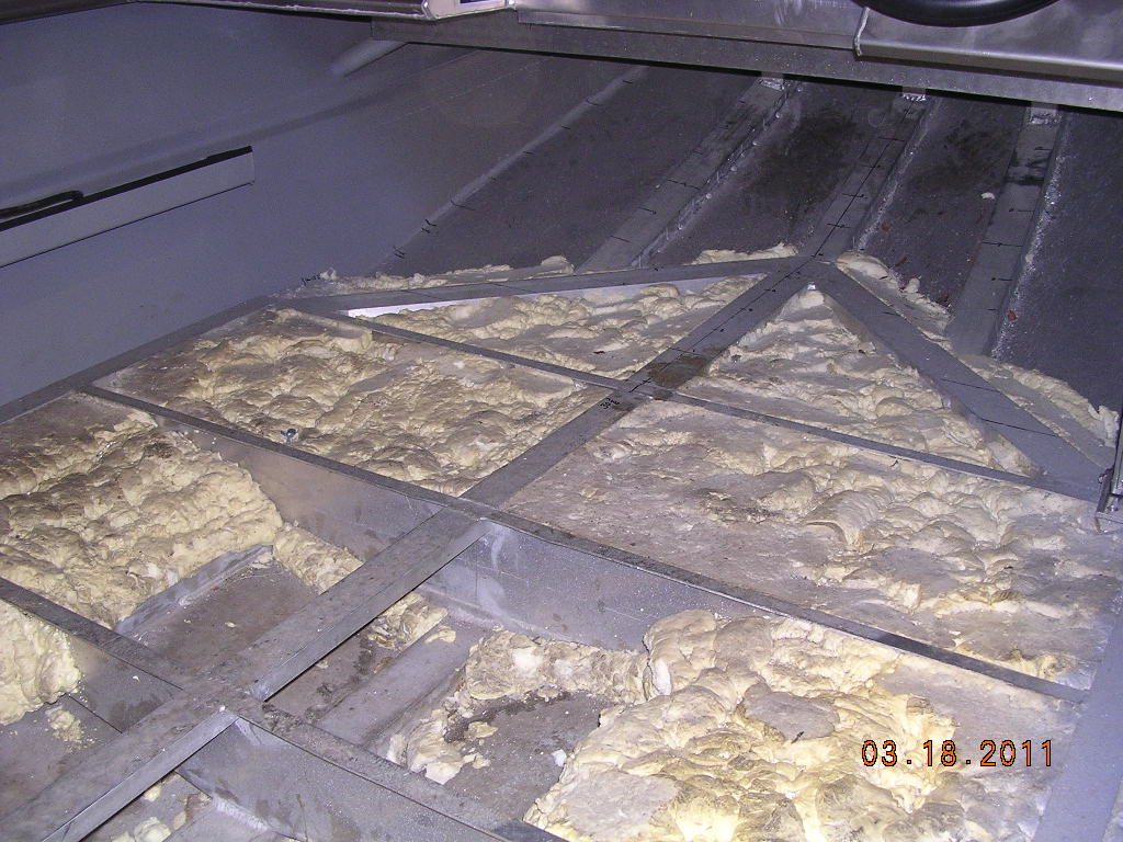

we do install foam REPEAT WE DO INSTALL FOAM in our boats. it is the last thing to go into the hull before the flooring goes on.
why are you so worried about foam . you act like you will not sleep very well if you do not see a picture of foam in my boat.
what is the big deal with the foam ? foam in the long run after a cpl your does nothing good but hold water and add weight to the boat. this is not good
here is some pictures of foam in my boat so maybe you can sleep well tonight after you look at them.
the amount of foam need in our boats can very from boat to boat base on what engine /pump and total weight of boat hull. does this make sense or not
the 2 boats for sergey are being shipped with out foam as this is how the were ordered. i hope this is alright with you that they have no foam in them
the last time i checked foam for flotation has nothing to do with how well the boat runs and drives . i must be missing something here that foam is such a big deal. you should stop dwelling on foam and start working on getting your boat to run good first . but that just me

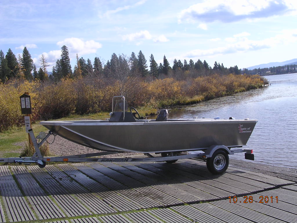

sure here is some more info on the boat in the pic
engine is a 85hp yamaha 2 cylinder 2 stroke
boat is 16' long
wt is 1150 lbs.
top speed with new super thick impeller is 38 miles per hour on the river or around 65-66 km/h
jet pump is aquajet 6" jet pump
i did not build the boat hull i just made it an inboard jet my installing jet pump then the engine
also built the oil tank to hold the oil for the oil injection that this engine has and the tank holds 2 gallons of oil so you can go for a few trips before having to had oil. it has 3 seats and 2 more fush mount seat bases so you can move the seats around for fishing. it has a gas pedal and single lever control for rev.
anchor light and bow nav light bilge blower fan and bilge pump. horn,swim deck,windshield. and fast steering that is 135 deg. from full left to full right.
also has the full 16 cubic feet of foam to meet the flotation for the coat guard .it also has oar locks so when you are fishing and drifting down the river you can keep the fisherman pointed in the right way.

in that last picture it shows some of the foam that is sprayed in for flotation
we use the foam that the coast guard requires us to use to meet the standards for flotation when installed in a inboard engine boat
this 16 foot long boat with an ecotec engine and scott jet pump requires 16 cubic feet of foam
it only has to keep the hole boat from sinking when to boat is flooded thats all. if it was an outboard jet the requirements are for the boat to float level wnen flooded. i know this does not make much sense but this is what the coast guard requires us to do
