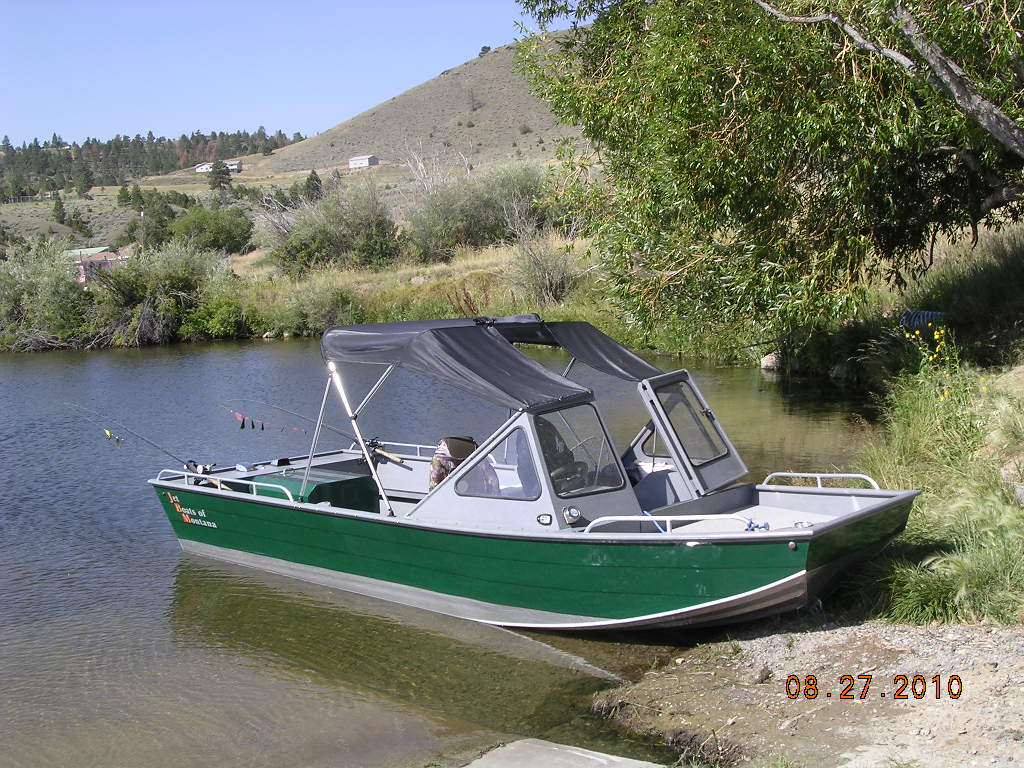

i am bill russell and i build these jet boats in montana USA
www.jetboatsofmontana.com

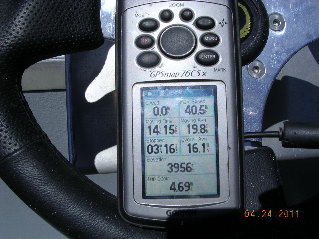

Tell me Bill, what you've achieved a maximum speed of the water jets, Scott 751, what engine showed the best result, with some impeller and the ring on the nozzle, at a boat?
Ajak
Сообщение bottomdweller » 04 дек 2011, 23:09
the boat with the ecotec 175 hp and the scott 751 jet pump went 40.1 miles per hour or about 65 kph at 4000 feet elevation

Сообщение bottomdweller » 06 дек 2011, 03:50
yes 40 miles per hour at 4000 ft elevation so on the river should see WOT speed of 44 miles per hour
we set the water cannon and engine up to give better low end grunt out of the hole to get on stem fast with big load like moose and deer
max rpm is 5400 rpm at 40.5 mph
all the boats we build we build for hunting so they can carry a big load at slower speeds and get better fuel burn rates
we need this more then fast top speed so we can go great distance on less fuel
is this translating good ? im not sure if it translates them same as i write. when i translate what you guys write in russian it translate only some of what you write
im not sure all you russian words translate with the same meanings . so im sorry if some of what i write does not come out clear
this boat has top speed of 40.5 mph and can carry alot of extra fuel and big load of game like moose and deer
this other boat with a weber 143hp turbo will run a top speed of 42 miles per hour with a scott 751 but it will not carry the same big load as the ecotec will

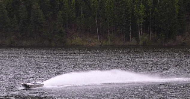

Сообщение bottomdweller » 06 дек 2011, 03:57
this weber here will run 44 miles per hour on the river
bottomdweller
