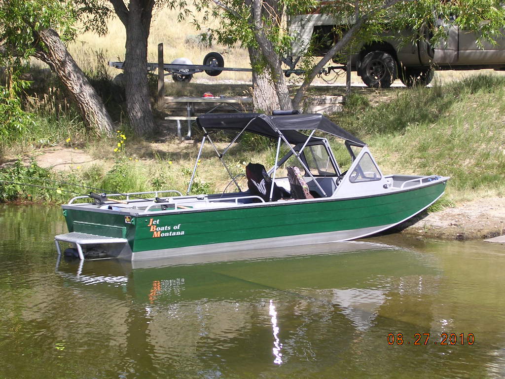

i like to use the weber 143 hp with the aquajet jet pump with our smaller lighter jet boats 14'-17"
this boat is 17' long with the weber 750 mpe 143 hp and the aquajet 6" jet pump. it gets up out of the water fast and has a top speed of 38 miles per hour on the river. this boat is 1100 lbs. or 500 kg . finished boat

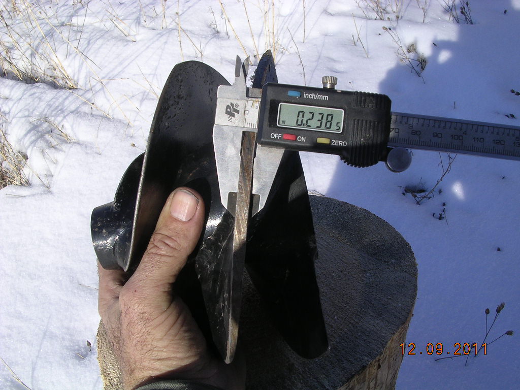

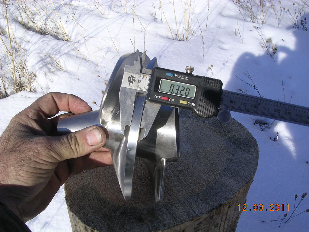

a couple more pix tho show the thickness next to a scott impeller

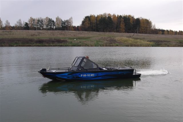

on pic. boat 17f +Weber 143 hp+Weber jetpump 73 kph (it is about 45 mph ?)
