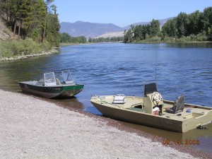

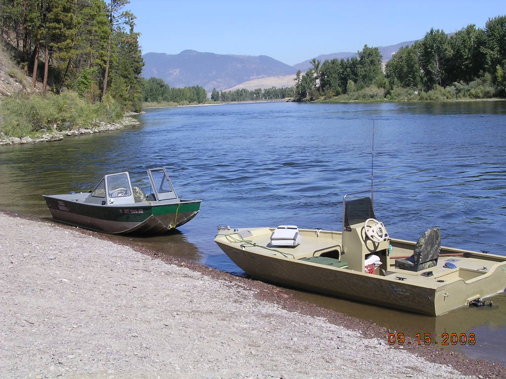

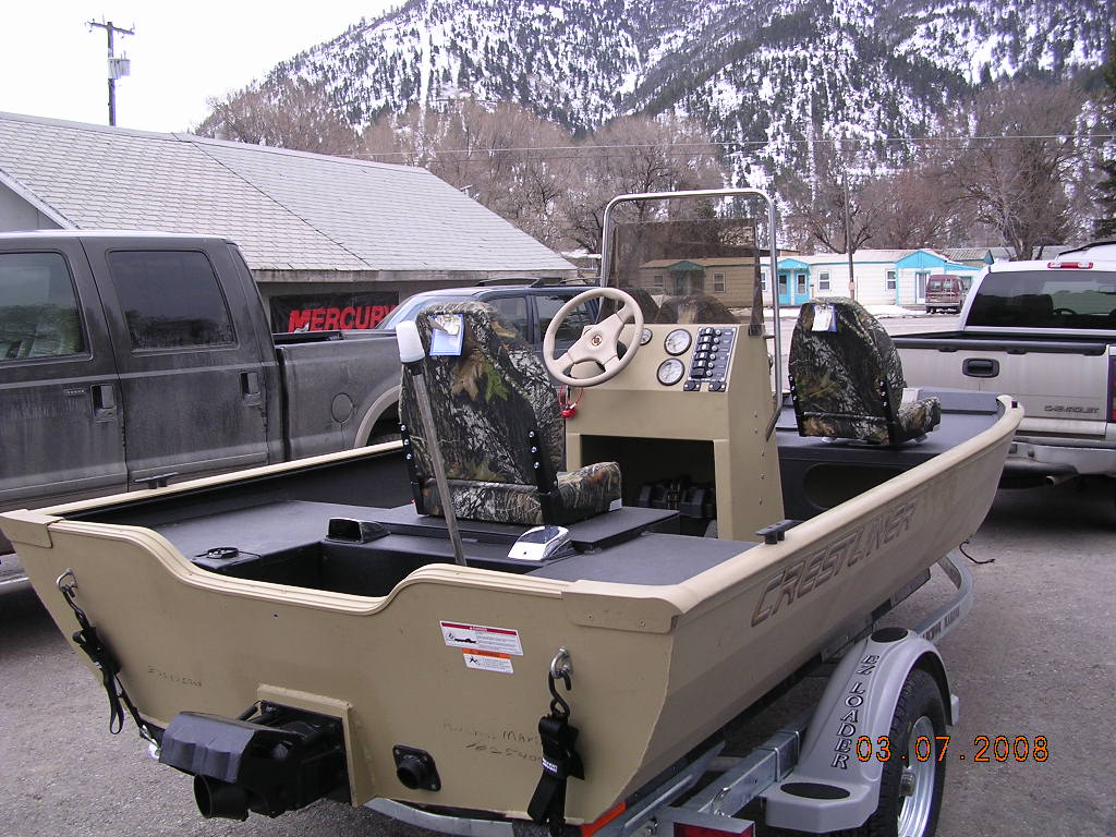

these are a 3 cylinder 2 stroke gas engine that needs 92 octane fuel and we premix the oil with the gas and has 3 carbs on it
the jet unit is 5 1/2"
here are the type of boats we would use them in
all are light duty with .125 [ 1/8" ] thick bottom to help keep the weight down of the boat
these are nise for the guy that is looking to keep the cost and weight down of the boat
for the price they are a very good deal.
in a boat like these here in the pictures that are from 900 lbs to 1100lbs they will run up to 36 miles per hour
